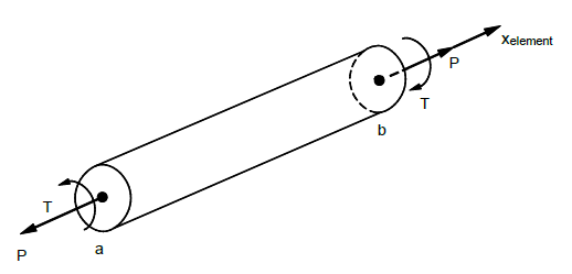

Figure 1: CROD element internal forces and moments
