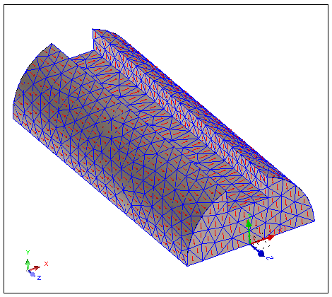

In this method, the normal vector along the v direction of the surface parameter space at a point closest to the element origin is projected on the element x-y plane to compute the material orientation.
The model shown in the figure above has a complex lofted geometry.
The Surface V Direction method effectively handles the orientation definition along the surfaces’ parametric space v vector.
