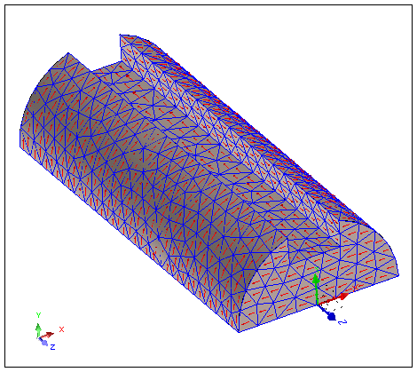

Surface -U Direction (Negative)
In this method, the tangent vector opposite to the u direction of the surface parameter space at a point closest to the element origin is projected on the element x-y plane to compute the material orientation.
The model shown in the figure above has a complex lofted geometry.
The Surface -U Direction method effectively handles the orientation definition opposite to the surfaces’ parametric space u vector.
