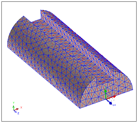

In this method, the normal vector opposite to the v direction of the surface parameter space at a point closest to the element origin is projected on the element x-y plane to compute the material orientation.
The model shown in the figure above has a complex lofted geometry.
The Surface -V Direction method effectively handles the orientation definition opposite to the surfaces’ parametric space v vector.
