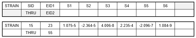

Format:
Example:
Alternate Format and Example:
