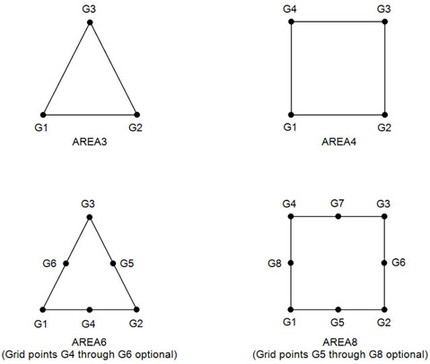

- TYPE specifies the kind of element surface. Supported types are REV, AREA3, AREA4, AREA6, and AREA8.

- TYPE = AREA3, AREA4, AREA6, or AREA8
These types have three and four primary grid points, respectively, that define a triangular or quadrilateral surface and must be ordered to go around the boundary. A property entry is required for convection, radiation, or thermal vector flux (see Figures 2 and 3).

Figure 2. Surface TYPE Definition
