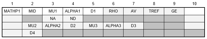

Format:
Example:
| Field | Definition | Type | Default |
| MID | Material identification number. | Integer > 0 | Required |
| MUi | Shear moduli related to distortional deformation. | Real | 0.0 |
| ALPHAi | Exponents related to distortional deformation. | Real | 0.0 |
| Di | Material constants related to volumetric deformation. | Real ≥ 0 | See Remark 2 |
| RHO | Mass density in original configuration. | Real | 0.0 |
| AV | Volumetric coefficient of thermal expansion. | Real | 0.0 |
| TREF | Reference temperature for the calculation of thermal loads. | Real | 0.0 |
| GE | Structural element damping coefficient. See Remarks 6 and 8. | Real | 0.0 |
| NA | Order of the distortional strain energy polynomial function. | 0 < Integer ≤ 3 | 1 |
| ND | Order of the volumetric strain energy polynomial function. | 0 < Integer ≤ 4 | 1 |
