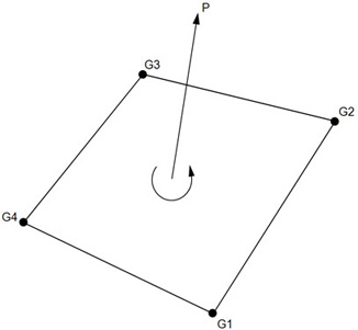

  4. In the case of a quadrilateral surface, the grid points G1, G2, G3, and G4 should form a consecutive sequence around the perimeter. The right-hand rule is applied to find the assumed direction of the pressure. Four concentrated loads are applied to the grid points in approximately the same manner as for a triangular surface. The following specific procedures are adopted to accommodate irregular and/or warped surfaces:

Figure 2. Pressure Convention for Quadrilateral Surface
