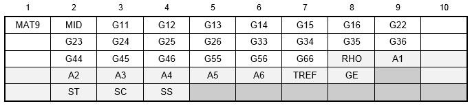

Format:

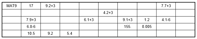

Example:
| Field | Definition | Type | Default |
| MID | Material identification number. | Integer > 0 | Required |
| Gij | Elements of the 6 x 6 symmetric material property matrix in the material coordinate system. | Real | Required |
| RHO | Mass density. | Real or blank | 0.0 |
| Ai | Thermal expansion coefficient vector. | Real or blank | 0.0 |
| TREF | Reference temperature for the calculation of thermal loads. | Real or blank | 0.0 |
| GE | Structural element damping coefficient. See Remarks 7 and 9. | Real or blank | 0.0 |
| ST, SC, SS | Allowable stresses in tension, compression, and shear, respectively. Required if composite element failure index is desired. | Real ≥ 0.0 or blank | 0.0 |

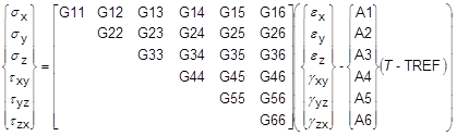

- The subscripts 1 through 6 refer to x, y, z xy, yz, zx of the material coordinate system (see the MCID field on the
PSOLID entry description). The stress-strain relationship is:
