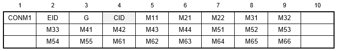

Concentrated Mass Element Connection, General Form
Description: Defines a 6-by-6 symmetric mass matrix at a geometric grid point.
Format:
Example:
| Field | Definition | Type | Default |
| EID | Element identification number. | Integer > 0 | Required |
| G | Grid point identification number | Integer > 0 | Required |
| CID | Coordinate system identification number for the mass matrix. | Integer ≥ 0 | 0 |
| Mij | Mass matrix values. | Real | Required |
Remarks:
- Element identification numbers must be unique with respect to all other element identification numbers.
- See the CONM2 entry description for a less general means of defining concentrated mass at grid points.
