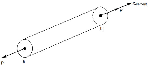

- This element will default to a circular bar in linear solutions. A nonlinear solution must be selected for tension-only behavior.
Figure 1. CCABLE Element Internal Forces
