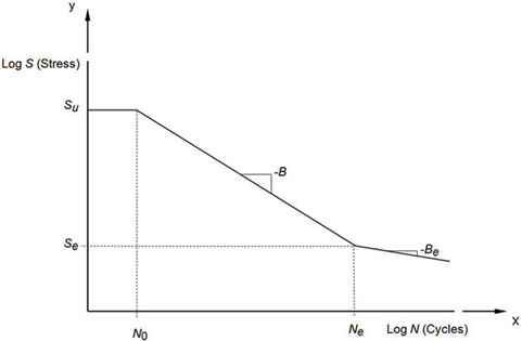

- The S-N curve shown in Figure 1 is characterized by the following equations:
If
If
where,
is the number of cycles to failure
is the amplitude of input stress (Smax - Smin)/2
is the number of failure cycles at the endurance limit
and the slope B shown in Figure 1 is calculated by:
- A small slope is required to prevent infinite life. See Figure 1.
Figure 1. Stress-Life Curve Format
