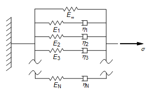

The viscoelastic relaxation occurs in the shear and/or bulk modulus. The modulus E in the following figure should be interpreted either shear modulus G or bulk modulus K.
Figure 1. Viscoelastic Material Idealization
Where,
is stiffness at an infinite time
is stiffness at the initial time
