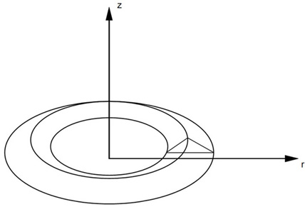

Axisymmetric Triangular Element Connection
Description: Defines an isoparametric axisymmetric triangular cross-section solid element with midside grid points.

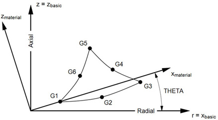

- The grid points must lie in the x-z plane of the basic coordinate system, with x = r ≥ 0. The grid points must be listed consecutively beginning at a vertex and proceeding around the perimeter in either direction. If the ID of any edge connection points is left blank or set to zero, the element equations are modified to give the correct results for the reduced number of connections. Corner grid points cannot be deleted.

- Material properties (if defined on a MAT3 entry) and stresses are given in the
coordinate system shown in Figure 2.
- A concentrated load (e.g.,
FORCE entry) at Gi is divided by the
times the radius to Gi and then applied as a force per unit circumferential length. For example, in order to apply a load of 100 N/m on the circumference at G1 (which is located at a radius of 0.5 m), the magnitude of the load specified on the static load entry must result in:
Figure 1. CTRIAX6 Element Idealization
Figure 2. CTRIAX6 Element Geometry and Coordinate Systems
