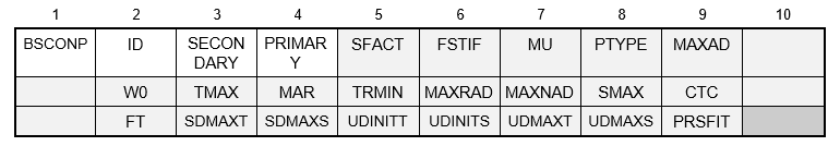

Surface Contact Parameters
Description: Defines the parameters for a surface contact region.
Format:
Example:
| Field | Definition | Type | Default | ||||||||||||
| ID | Contact region identification number. | Integer > 0 | Required | ||||||||||||
| SECONDARY | Secondary region identification number. | Integer > 0 | Required | ||||||||||||
| PRIMARY | primary region identification number. | Integer > 0 | Required | ||||||||||||
| SFACT | Stiffness scaling factor used to scale the penalty values determined automatically. See Remark 4. | Real > 0.0 | 1.0 | ||||||||||||
| FSTIF | Frictional stiffness for stick. See Remarks 5 and 12. | Real ≥ 0.0 | Model dependent | ||||||||||||
| MU | Coefficient of static friction. | Real ≥ 0.0 | 0.0 | ||||||||||||
| PTYPE | Penetration type. See Remarks 6 and 7.
1 ≤ Integer ≤ 11 | 1 | ||||||||||||
| MAXAD | Maximum activation distance. See Remark 8. | Real ≥ 0.0 or AUTO | See Remark 8 | ||||||||||||
| W0 | Penetration surface offset. See Remark 9. | Real | 0.0 | ||||||||||||
| TMAX | Maximum allowable penetration used in the adjustment of penalty values normal to the contact plane. A positive value activates the penalty value adjustment. See Remark 10. | Real ≥ 0.0 | See Remark 10 | ||||||||||||
| MAR | Maximum allowable adjustment ratio for adaptive penalty values K and FSTIF. See Remark 11. | Real > 1.0 | 100.0 | ||||||||||||
| TRMIN | Fraction of TMAX defining the lower bound for the allowable penetration. See Remark 12. | 0.0 ≤ Real ≤ 1.0 | 0.001 | ||||||||||||
| MAXRAD | Maximum radial activation distance. See Remark 13. | Real ≥ 0.0 | 0.0 | ||||||||||||
| MAXNAD | Maximum normal activation distance. See Remark 13. | Real ≥ 0.0 | 0.0 | ||||||||||||
| SMAX | Maximum allowable slip used in the adjustment of penalty values parallel to the contact plane (FSTIF). A positive value activates the penalty value adjustment. See Remark 14. | Real ≥ 0.0 | 0.0 | ||||||||||||
| CTC | Contact thermal conductance. See Remark 15. | Real ≥ 0.0 | ∞ | ||||||||||||
| FT | Failure theory. The following weld bond failure theories are allowed.
Character or blank | WFM | ||||||||||||
| SDMAXT | Tensile stress of the weld bonding material when damage initiates. See Remark 16. | Real ≥ 0.0 or blank | 0.0 | ||||||||||||
| SDMAXS | Shear stress of the weld bonding material when damage initiates. See Remark 16. | Real ≥ 0.0 or blank | 0.0 | ||||||||||||
| UDINITT | Separation normal to the primary weld surface when bond damage initiates. See Remark 16. | Real ≥ 0.0 or blank | 0.0 | ||||||||||||
| UDINITS | Slip tangential to the primary weld surface when bond damage initiates. See Remark 16. | Real ≥ 0.0 or blank | 0.0 | ||||||||||||
| UDMAXT | Separation normal to the primary weld surface when bond damage results in complete failure. See Remark 16. | Real ≥ 0.0 or blank | 0.0 | ||||||||||||
| UDMAXS | Slip tangential to the primary weld surface when bond damage results in complete failure. See Remark 16. | Real ≥ 0.0 or blank | 0.0 | ||||||||||||
| PRSFIT | Press fit option, one of the following character variables: YES or NO. See Remark 17. | Character | NO |
