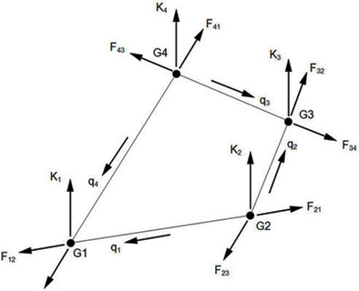

Shear Panel Element Connection
Description: Defines a shear panel element.
Format:
Example:
| Field | Definition | Type | Default |
| EID | Element identification number. | Integer > 0 | Required |
| PID | Identification number of a PSHEAR property entry. | Integer > 0 | Required |
| Gi | Grid point identification numbers of connection points. | Integer > 0, all unique | Required |
Remarks:
- Element identification numbers must be unique with respect to all other element identification numbers.
- Grid points G1 through G4 must be ordered consecutively around the perimeter of the element.
- All the interior angles must be less than 180°.
Figure 1. CSHEAR Element Connection and Coordinate System
Figure 2. CSHEAR Element Corner Forces and Shear Flows
