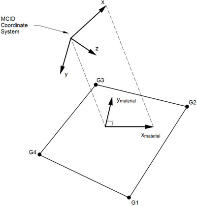

Figure 1. MCID Coordinate System Definition

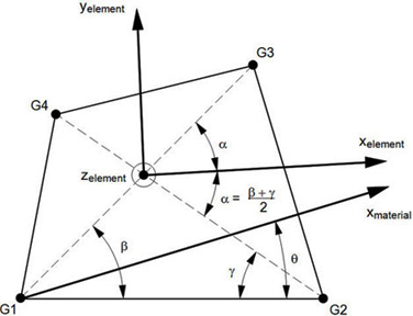

Figure 2. CQUADR Element Geometry and Coordinate System
