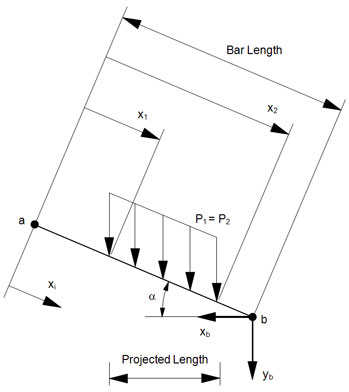

- If SCALE = LE (length), the Xi values are actual distances along the bar x-axis, and (if X1 ≠ X2) Pi are load intensities per unit length of the bar.
- If SCALE = FR (fractional), the Xi values are ratios of the distance along the axis to the total length, and (if X2 ≠ X1) Pi are load intensities per unit length of the element.
- If SCALE = LEPR (length projected), the Xi values are actual distance along the bar x-axis and (if X2 ≠ X1) the distributed load is input in terms of the projected length of the bar.
Figure 1. PLOAD1 Convention on Bar and Beam Elements
- If SCALE = LE, the total load applied to the bar is P1(X2 - X1) in the yb direction.
- If SCALE = LEPR, the total load applied to the bar is P1(X2 - X1)COS(α) in the yb direction.
- If SCALE = FRPR (fractional projected), the Xi values are ratios of the actual distance to the length of the bar and (X1 ≠ X2) the distributed load is input in terms of the projected length of the bar.
