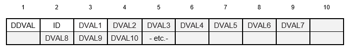

Discrete Design Variable Values
Description: Defines real, discrete design variable values for design optimization.
Format:
Example:
Alternate Format and Example:
| Field | Definition | Type | Default |
| ID | Discrete value set identification number. | Integer > 0 | Required |
| DVALi | Discrete values. | Real | Required |
| INC | Discrete value increment. | Real | Required when using alternate format |
Remarks:
- DDVAL entries must be referenced by a DESVAR entry in the DDVAL field.
