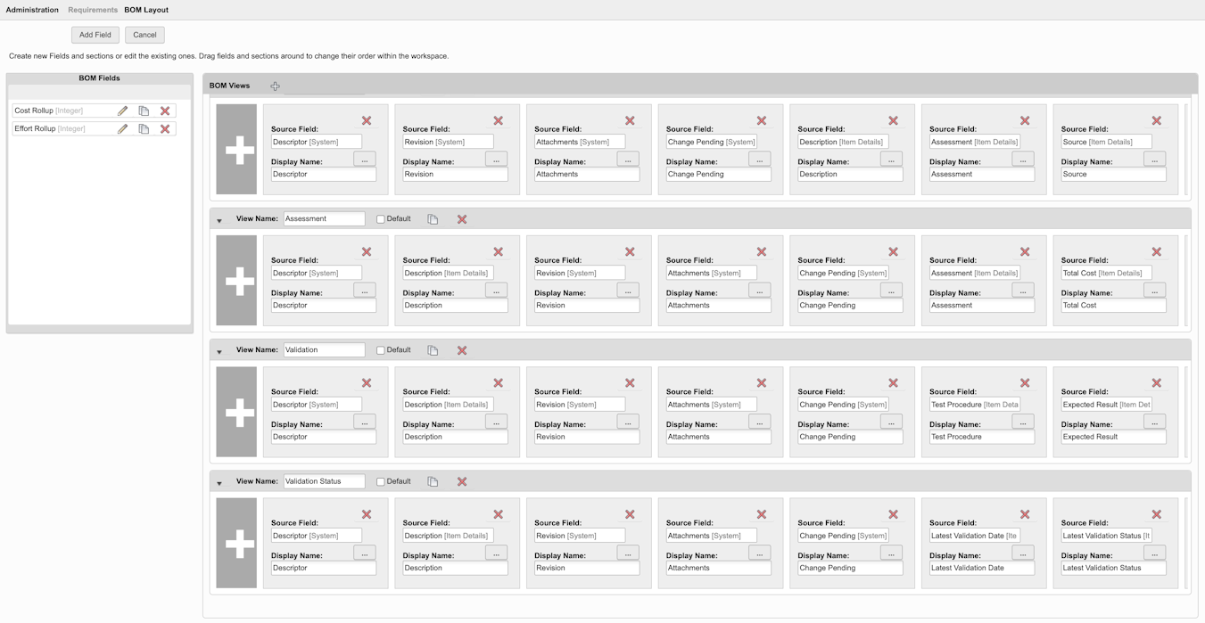

The Bill of Materials tab of the Requirements workspace is used to manage and explore the hierarchy of requirements. You may want to configure standard BOM views to make the most of this template’s mechanism.
bom layout
This topic includes a list of views with recommended columns. These views cannot be provided by the Template Library and must be created by the site administrator. These views are not technically required, and you can choose the columns (sequence) as you like. However, the following list of views probably will address most of your user’s needs and are better starting point than the standard views provided by the Template Library.

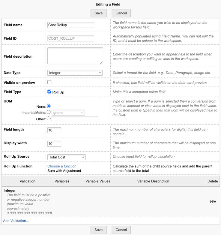

Note that the view Assessment mentioned below also contains two BOM rollup columns to determine the total cost and total effort. If these rollups are used, click Add Field to create these two fields:
Field Cost Rollup Field Effort Rollup
cost rollup effort rollup
Keep in mind that you can clone existing views to easily reuse column definition across all views when creating these views.
View Name
Table Columns
Definition
Descriptor
Revision
Change Pending
Description
Assessment
Source
Type
Reference Alerts
Assessment
Descriptor
Description
Revision
Change Pending
Assessment
Reference Alerts
Total Cost
Cost Rollup
Effort [days]
Effort Rollup
Validation
Descriptor
Description
Revision
Change Pending
Test Procedure
Expected Result
Success Criteria
Validation Status
Descriptor
Description
Revision
Change Pending
Latest Validation Date
Latest Validation Status
Validation Process
Last Validation Process
Test Procedure
Expected Result
Success Criteria
