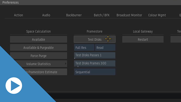

Preferences: The Support tab is no longer available in the Preferences. To provide the log files to the Autodesk support team, use the script /opt/Autodesk/<version>/bin/ftpuploadlogs.py .
Project Management: When you create a project, the Volume creation settings are now displayed in a window.
