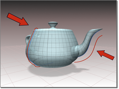

This command creates a curve that is offset from a curve that lies on a surface. In other words, the parent curve must have one of the following types: surface-surface intersection, U iso, V iso, normal projected, vector projected, CV curve on surface, or point curve on surface. The offset is normal to the surface. That is, the new curve is either above or below the surface by the offset amount.
Creating surface offset curves
Procedures
To create a surface offset curve:
- In the NURBS toolbox, it, turn on
(Create Surface Offset Curve). - Put the cursor over a curve that lies on a surface, and drag to set the offset amount. Release the mouse button to end curve creation.
