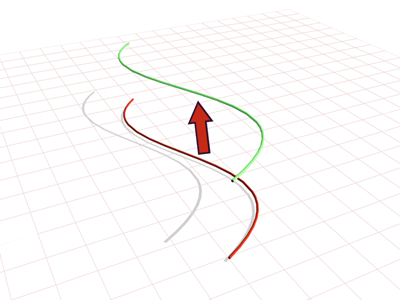

A transform curve is a copy of the original curve with a different position, rotation, or scale.

Curve used to create a transform curve

  • In a NURBS object that contains at least one curve, turn on (Create Transform Curve).
    To move the transform curve, click and drag the curve you want to duplicate. To rotate or scale the transform curve, click the parent curve, go to the Curve sub-object level in the modifier stack, and then rotate or scale the transform curve.
    When you use Move to create the transform curve, it simply copies the parent. (It doesn't exaggerate curvature as an offset curve does.)
    Axis constraints don't apply to the creation of transform curves. You can click to create the curve in place; then once it is created, transform it using constraints.
    Tip: You can also use axis constraints by using Shift+Clone at the Curve sub-object level.
