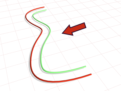

An Offset curve is offset from the original, parent curve. It is normal to the original. You can offset both planar and 3D curves.
  • Select a NURBS object. > Modify panel > Create Curves rollout > Dependent Curves group box > Offset button
  • Select a NURBS object. > Modify panel > NURBS toolbox > (Create Offset Curve)
Curve used to create an offset curve

  1. In the NURBS toolbox, turn on (Create Offset Curve).
  2. Click the curve you want to offset, and drag to set the initial distance.
    An offset curve is created.
  3. Adjust the Offset parameter.
    If the parent curve is not linear, increasing the distance increasingly exaggerates the curvature of the offset curve.
