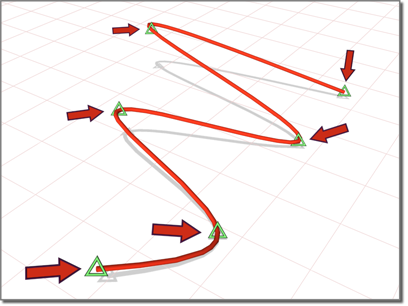

This command creates a point curve fitted to points you select. The points can be part of previously created point curve and point surface objects, or they can be point sub-objects you created explicitly. They can't be CVs.
Fitting a curve to selected points
Procedures
To create a point curve with Curve Fit:
- In the NURBS toolbox, turn on
(Create Fit Curve). - Click two or more points.
A point curve is created. It runs through the points you select, in the order you select them.
You can press Backspace to undo point selection in reverse order.
- Right-click to end creation.
