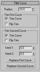

Fillet Curve rollout (creation time)
- Radius
The radius of the fillet arc in the current 3ds Max units. Default=10.0.
This parameter is animatable.
Tip: If the fillet you initially create is in an error state, often this is because the radius is not large enough to bridge the distance between the two curves. Increasing the Radius value gives you a correct fillet. The fillet becomes an arc displayed in the dependent object color (green by default). When the fillet is in an error state it is displayed as a straight line in the error color (orange by default).
Trim First Curve and Trim Second Curve groups
These two groups let you control how the parent curves are trimmed. The controls are the same in each. "First" and "second" refer to the order in which you picked the parent curves.
- Trim Curve
When on (the default), trims the parent curve against the fillet curve. When off, the parent isn't trimmed.
- Flip Trim
When on, trims in the opposite direction.
- Seed 1 / Seed 2
Change the U location of the seed value on the first and second curves. If there is a choice of directions, the direction indicated by the seed points is the one used to create the fillet.
Fillet Curve rollout (modification time)
- Radius
- Trim Curve
- Flip Trim
- Seed 1 / Seed 2
- Replace First Curve / Replace Second Curve
Let you replace the parent curves. Click a button, then click the curve to replace the original first or second curve.
