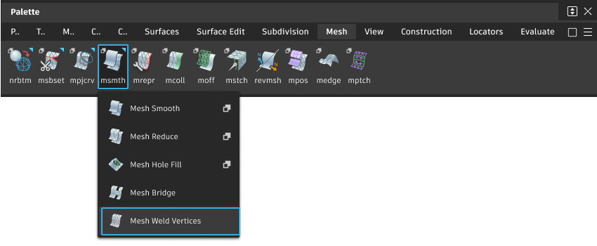

Access this tool from the Mesh tool palette:

  1. Select the Mesh Weld Vertices tool .
