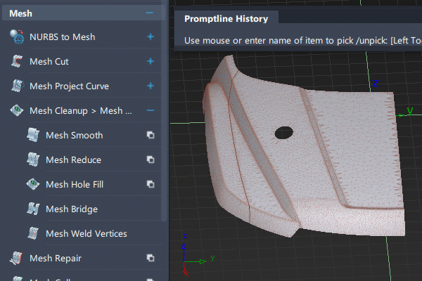

Fills holes in a mesh. Use this tool to fill small holes, or holes located in an area of the mesh which is relatively flat and has no features. To eliminate narrow gaps between boundaries, use the Mesh Stitch tool.

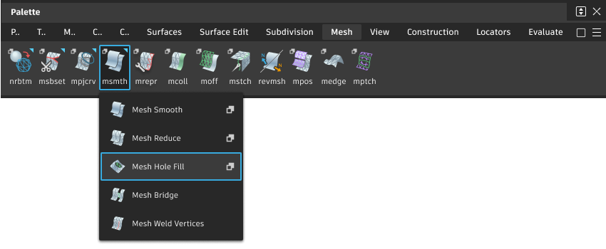

Access this tool from the Mesh tool palette:

Select the Mesh Hole Fill tool

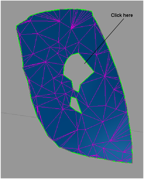

All the mesh boundaries are highlighted in green.
Select the boundary of the hole you wish to fill.
The hole is filled with a mesh that attempts to maintain the curvature properties across all of the triangles that fill the hole (when Quality option is set to Faired).
