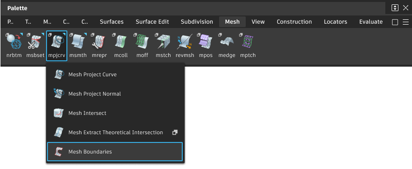

Access this tool from the Mesh tool palette:

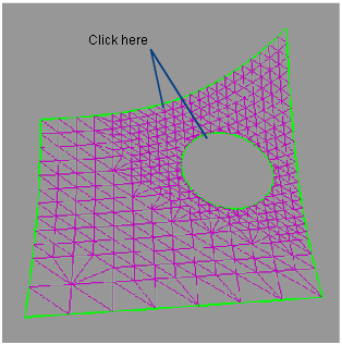

All the mesh boundaries are highlighted in green.
Do one of the following:
Click on the boundary or boundaries you want to extract (they turn yellow), then press the Extract button at the bottom of the window.

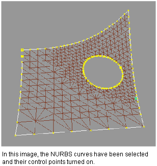

One or more degree 1 NURBS curves are created and overlap the boundaries of the mesh.
