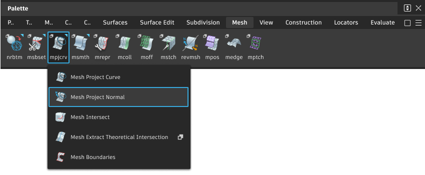

Access this tool from the Mesh tool palette:
