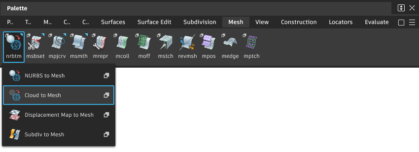

Access this tool from the Mesh tool palette:

- Import the cloud data into Alias (File > Import > Cloud).
- Select the cloud.
- Select the Cloud to Mesh tool.
