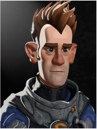

In this simple 'making of' tutorial, we will break down the steps used to render the image above using the Toon shader. We will cover how to use the Rim Lighting, Base Tonemap, Specular Tonemap, and Stylized Highlight attributes of the Toon shader to create a 'painterly' type portrait of our intergalactic hero Sven!

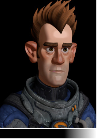

Base Tonemap (ramp)
  • Create a ramp similar to the one below and connect it to the Base Tonemap of the Toon shader assigned to Sven's face.
Ramp RGB -> Base Tonemap

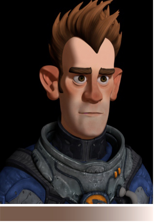

Specular Tonemap (ramp)
  • Lower the Specular Weight to around 0.1 and increase the Specular Roughness to around 0.7.
  • Create a ramp and connect it to Specular Tonemap.
Ramp RGB -> Specular Tonemap
Rim Lighting
  • Create a Spot Light and position it so that it is pointing at Sven from behind and at an angle. Add it to the Rim Lighting-> Light attribute.
  • Create a Ramp RGB and connect it to Rim Lighting Color.
Light -> Rim Lighting

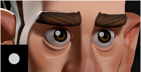

Stylized Highlight
We can use the Stylized Highlight to create a cartoon-style highlight on Svens's eyes.
  • Create a Spot Light and point it at Svens' eyes. Hide the light so that it does not illuminate Sven.
  • Connect a circular ramp (similar to the one below) to the Stylized Highlight Color of the Eye shader and increase the Stylized Highlight Size to around 0.8.
Stylised Highlight (specular reflection)

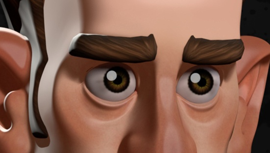

Indirect Specular
Indirect Specular (and Indirect Diffuse) can have a subtle effect on the appearance of the Toon shading. In this case, Indirect Specular: 0 works better for the eye shader.
