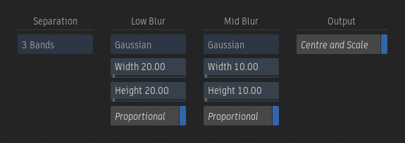

Settings
Separation
Separation Mode
Select whether the Front image is separated in 2 or 3 bands.
When 2 Bands is selected, the image is split into two frequency bands: Low Frequency and High Frequency. The colours removed from the Low band are moved to the High Frequency output.
When 3 Bands is selected, the image is split into three frequency bands: Low Frequency, Mid Frequency, and High Frequency. The colours removed from the Low band are moved to the Mid Frequency output. The colours removed from the Mid band are moved to the High Frequency output.
Low Blur
Low Blur option
Select whether the separation is performed using a Gaussian or Box blur.
Width field
Sets the width of the Low Blur.
Height field
Sets the height of the Low Blur.
Proportional
Enable to affect the width and height proportionally.
Mid Blur
Mid Blur option
Width field
Sets the width of the Mid Blur.
Height field
Sets the height of the Mid Blur.
Proportional
Output
Centre and Scale
Enable to scale pixel values by half and centre them around middle grey (0.5) rather than black (0.0). When enabled, the modified high frequency and low frequency outputs must be composited back together using the Flame or Photoshop Linear Light blending mode. When disabled, they must be composited back together with the Flame Add blending mode.
The Flame Linear Light blending mode achieves the same blending operation as the Photoshop Linear Light one, but without clamping pixel values.
