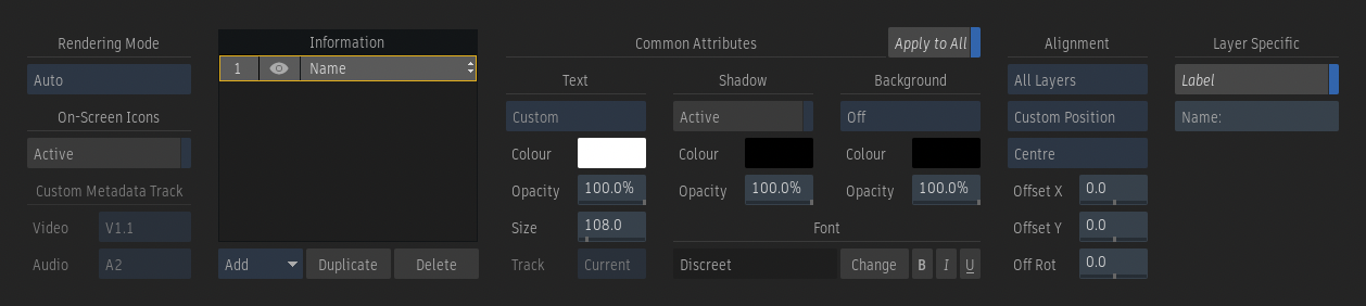

The Burn-In Metadata settings in Batch
The Burn-In Metadata settings in the Effects environment

Information list
Lists all of the added information layers. Use the buttons below to populate the list with the information layers you want. Use the eye icon to mute a layer. Click a layer to display its Layer Specific options.
