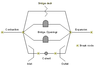

In the simulation engine, the bridge object is modelled as a set of objects as described in the schematic below.
  • Contraction reach consisting of two sections and user-supplied loss coefficients with ineffective flow areas blocking the conveyance parts of the downstream section
  • A node
  • In parallel:
    • A conduit link for each bridge opening, with piers and a user-supplied pier loss coefficient
    • An entry, an exit and a conduit for each culvert
    • An irregular weir for overtop flow
  • A node
  • Expansion reach consisting of two sections and user-supplied loss coefficients, with ineffective flow areas blocking the conveyance parts of the upstream section

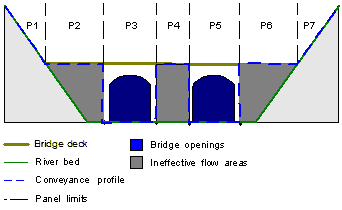

Ineffective flow areas
Ineffective flow areas represent the areas outside of openings where no flow occurs until overtopping of the road deck occurs.
InfoWorks ICM determines the ineffective flow areas from bridge opening geometry. For example, a single opening bridge will have two ineffective flow areas: one from the left bank to the left of the bridge opening, and one from the right of the bridge opening to the right bank.

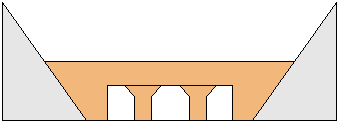

Bridge openings
The location of openings in the bridge section are specified via the Bridge property sheet. The geometry of an opening is defined as a Bridge Opening object. The geometry and location of piers within each opening can also be defined in the Bridge Opening object. Bridge openings can be associated with bridge sections manually by entering details in the Bridge property sheet, or by using the Build bridge openings tool.
Bridge openings are modelled by using the standard conduit methodology (see the Hydraulic Theory topic) with added support for non-prismatic openings and the presence of piers.
Where piers are defined within the opening, the section geometry of the conduit representing the opening is determined as follows:
  • subtract pier area from conduit area
  • subtract total pier width from conduit width
  • add wetted perimeter for pier sides
  • subtract wetted perimeter at invert and soffit
Roughness values are required for both opening and pier surfaces. An equivalent friction factor is determined for the whole wetted perimeter. A fixed headloss may also be defined in the Bridge Opening object to represent pier losses.
