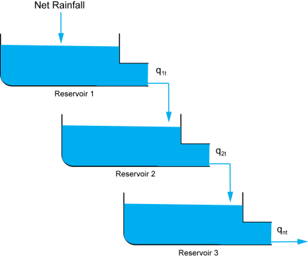

In the Cascade Routing Model, flow is routed using a specified number of linear reservoirs in series; each reservoir has the same (user-defined) time constant.
For each storage reservoir, the storage constant, K, is used and calculated as follows:
First reservoir in series:
(1)
Second reservoir in series:
(2)
..final reservoir in series:
(3)
Where:
q1 is the runoff from the first reservoir
q2 is the runoff from the second reservoir
qn is the runoff from the last reservoir
t is time in seconds
I is the rainfall intensity
K is the storage constant
The linear cascade is implemented for each reservoir using a finite difference approximation.
