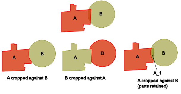

    • Retain all the separate parts of the cropped objects - if this option is checked, new objects will be created if cropping of an object results in the original object being split into multiple parts. If this option is unchecked, only one part of the object is retained. (Applies to cropping of polygons and to cropping of lines against polygons. When cropping lines against lines, all parts of the line are always retained.)

Selected objects will be cropped against objects of the appropriate type selected in the Crop against selection. If there is no Crop against selection, objects will be cropped against all adjacent/intersecting objects of the appropriate type.
If the Do not crop polygons with overlaps greater than (% of polygon size) option has been selected, any overlaps that are larger than the value specified in the percentage size box, will not be cropped.
If the Retain separate parts option is checked, created polygon objects will be named based on the ID of the original polygon and will inherit the properties of the original polygon with the exception of Subcatchment and Storage Node IDs.

Cropping Polygons Examples
