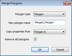

This dialog is used to merge a pair of polygon objects of the same type to produce a single polygon.
To display the dialog, select a pair of polygon objects of the same type on the GeoPlan Window and choose the GeometryMerge polygons option from the Model menu.
Dialog description
Field
Description
Polygon type
The type of polygon to be merged.
If more than one pair of polygon objects are selected, the type of polygon to be merged can be selected from the dropdown list.
New polygon name
Name to be given to the newly created polygon.
Copy properties from
Dropdown list of polygons to be merged. The newly created polygon will inherit the properties from the polygon selected from this list.
Remove old polygons
Check this option to delete the original selected polygons on creation of the new combined polygon.
If this option is unchecked, the existing polygons will remain unchanged when the combined polygon is created; the existing polygons will have to be deleted manually.
