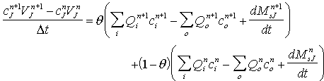

A time weighted method described by Johnson and Riess (1982) is used to discretise the conservation of mass equation at each node.
(6)
where
0 θ 1 is the time-weighting parameter.
A value of θ 0.5 ≥ is necessary for stability. The highest order of accuracy of the scheme is given by θ = 0.5 for instance the Crank-Nicolson method (Johnson and Riess (1982)) but the solution may be oscillatory. The value θ = 1 (as set in the default water quality simulation parameters file default.qsm distributed with InfoWorks ICM), for instance the implicit Euler method (Johnson and Riess (1982)) is recommended to avoid unphysical oscillations in the solution.
The ci n+1 are obtained by performing a Holly-Preissmann step at the inflow from link i to node J. If the trajectory passes straight through link i during the time step, the ci n+1 is related to the concentration in the node upstream of link i. This relationship, which occurs for all control structures, means that finding the solution for the nodal concentrations involves solving a matrix system. This is done using the MA48 nonsymmetric matrix solver (Harwell Subroutine Library (1993)).
