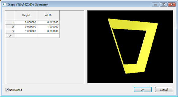

Symmetric Shape
0.15m wide at the base 0.4m wide at the top and 0.6m high (enclosed sewer).
The largest height is 0.6 m, therefore it gets given a value of 1.
The largest width is 0.4 m therefore it gets given a value of 1.
The base width of 0.15 becomes 0.15/0.4 (0.375) in the new factored system.
The Shape Geometry Editor should look like this:
  • Start at height = 0. At height = 0, width is 0.15 m, which corresponds to a factor of 0.15/0.4 = 0.375
  • Next height is height = 1. At this height, width is at its maximum (0.4 m), so its gets given a factor of 1
  • Because we have a symmetric shape that is enclosed, we must specify a width of 0 at height = 1.
  • As we cannot have two lines with the same height, a value of 0.999990 or 0.999900 must be entered instead in the middle row.
Click on OK on the editor above.
In the Cross Section section of the Conduit Property Sheet, enter 400 mm in the Width box and 600 mm in the Height box. It is important to enter the real values, not the factored values.

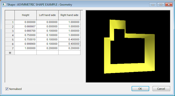

Asymmetric Shape
Asymmetric shape as shown in the picture below:
The largest width is 0.5 m therefore it gets given a value of 1.
The other heights and widths should be calculated as functions of the maximum values, e.g. width of 0.05 m at 0.4 m height becomes 0.05/0.5 = 0.1.
For an asymmetric shape, it may be useful to project the geometry on the Y axis (height) to work out which points will be needed to build the shape in the software, and what their coordinates will be. Left and Right values are attributed according to the projection of the point on the far left and far right sides.
  • Start at height = 0 (Point 1). At height = 0 the width is at its maximum, therefore Left = 0 (far left) and Right = 1 (far right)
  • The next height is 0.4 m which corresponds to a factor of 0.666667 (factor of 0.4/0.6). This is Point 2 in the screenshot above. At this point, the width is still at its maximum therefore Left = 0 (far left) and Right = 1 (far right)
  • The next point up is Point 3. Its height is the same as Point 2's so we are going to give it a height of 0.666700 (values must differ by at least 0.000010). Left = 0.1(= 0.05/0.5) and Right = 1 (far right).
  • The next point up is Point 4. Its height is 0.45 m, or 0.45/0.6 = 0.75. Left = 0.1 (0.05/0.5) and Right = 1 (far right).
  • The next point up is Point 5. Its height is the same as the one for point 4 so we are going to allocate it a height of 0.750010. Left = 0.1 (0.05/0.5) and Right = 0.4 (0.2/0.5).
  • Next point is Point 6. Point 6 height is 0.6, therefore a factor of 1 (because of the next bullet point, we will enter a value of 0.999900 instead). Left and Right are the same as for Point 5 : Left = 0.1 (0.05/0.5) and Right = 0.4 (0.2/0.5).
  • Finally as the shape is enclosed, we need to add a final line at height = 1, for which Left and Right are equal to one another. Any factor between 0.1 (0.05/0.1) and 0.4 (0.2/0.5) can be chosen. Left = Right = 0.2.
Click on OK on the Shape Geometry Editor.
In the Cross Section section of the Conduit Property Sheet, enter 500 mm in the Width box and 600 mm in the Height box. It is important to enter the real values, not the factored values.
