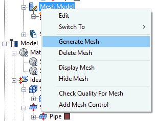

Generate Mesh
Click Generate Mesh in the Mesh panel on the Inventor Nastran ribbon tab or right-click on Mesh Model and select Generate Mesh.
You must regenerate the mesh whenever a change is made to any feature in the model.
For assemblies, this command creates an automatic mesh on all of the parts using the default or specified mesh sizes.
A progress bar visually indicates the progress of the meshing operation.
