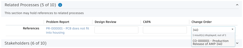

If you want to link the current request to an existing change order, select the process in the Related Processes section. When you select an existing process, the system links the current request to that change order instead of creating a new one. This mechanism also allows you to connect multiple change requests to a single change order.

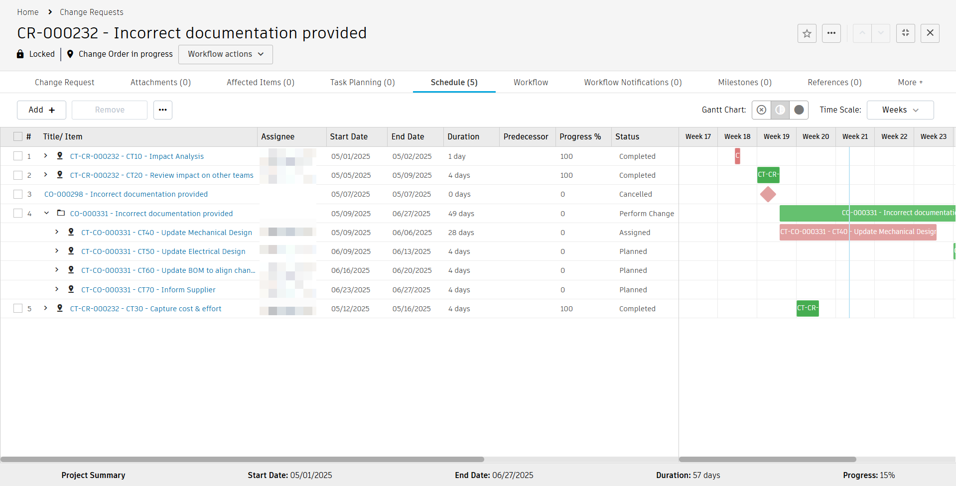

Once the system initiates a change order for a change request, it displays the change order in the request’s Schedule tab for easy tracking. This view also provides access to tasks performed in the context of the change order.
