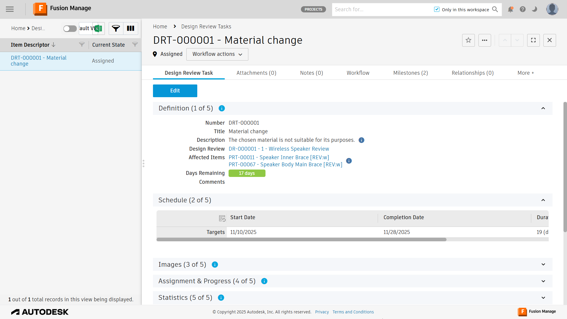

  1. From the My Outstanding Work section of the dashboard, click to open your assigned task.
  2. Review the task details. Information is taken from the parent design review.
  3. When you are ready to begin work on the task, click the workflow actions menu and select Acknowledge.
    The workflow moves from the Assigned to the In Work state.

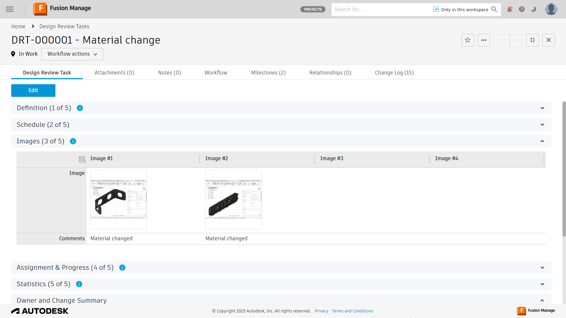

  1. Update the task with information about the work you completed, such as images and attachments.
    work on task
  2. When the rework is finished, there are two options:
    • Click the workflow actions menu and select Finish Task.
      The workflow moves from In Work to Complete state.
    • If a reviewer was specified for the task, click the workflow actions menu and select Submit for review.
      The workflow moves to the Review state. The reviewer must now determine if the task has been completed successfully and either finish the task or send it back to the assignee for further work.
