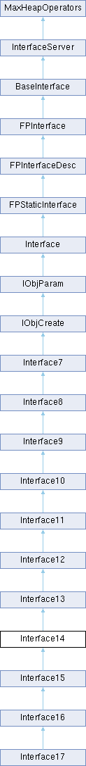

3ds Max C++ API Reference
Extends Interface13 Client code should retrieve this interface using GetCOREInterface14. More...
#include <C:/adskgit/3dsmax/3dsmax/3dswin/src/maxsdk/include/maxapi.h>
