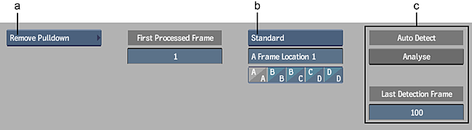

When removing a pulldown, you can analyse the clip to automatically detect the type of pulldown and the A frame. If the analysis fails to determine the type of pulldown or the location of the AA frame, manually set the Pulldown and the A Frame Location options.
(a) Pulldown Mode option box (b) Pulldown Type option box (c) Remove Pulldown options; available when Pulldown Mode is set to Remove Pulldown
Pulldown type option box
Select an option to add or remove pulldown from the clip.
First Rendered Frame field
Displays the first frame at which the output is rendered from the node. Editable.
Pulldown option box
Select the type of pulldown process to apply to the clip.
A Frame Location field
Displays the value of a reference (AA) frame. The selected frame becomes the frame of reference when adding or removing pulldown frames. Editable.
Analyze button
Click to determine the type of pulldown used and the A frame.
Last Detection Frame field
Displays the value of the last frame of the clip used by the Analyse button. Selecting a subset of a clip speeds up the analysis. Editable.
