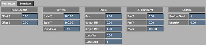

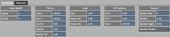

Some of the settings in the Parameters tab vary depending on the chosen preset, while other settings, such as Zoom, Random Seed, and Disorder are present in every Substance preset. You can get a quick description of each setting by viewing its tooltip.
Example of Noise parameters
Example of Splatter parameters

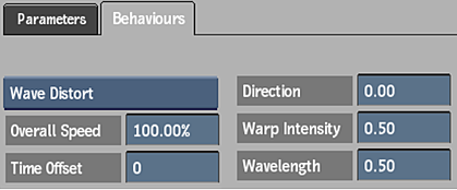

Wave Distort
Directional warping effect that deforms the pattern with different wavelength warps.
You can adjust the playback rate and timing of your chosen behaviour animation by using the Overall Speed and Time Offset settings (available for all behaviours).

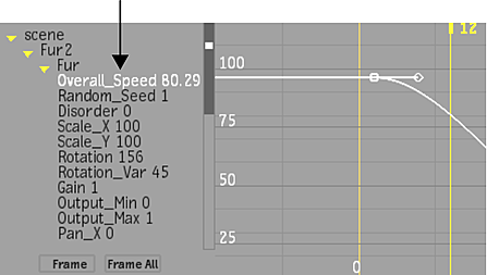

You can also adjust the Overall Speed in the Channel Editor.
