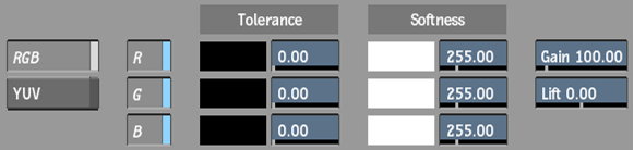

Difference Matte Menu Settings
General Settings
You can enable the RGB or the YUV settings to generate a matte clip.
RGB Settings
RGB button
Enable to use values in the RGB colour space to generate a matte.
R button
Enable to use the red colour channel to create the matte.
G button
Enable to use the green colour channel to create the matte.
B button
Enable to use the blue colour channel to create the matte.
Red Tolerance colour pot
Displays the value of the red channel used to create the matte. Editable.
Red Tolerance field
Green Tolerance colour pot
Displays the value of the green channel used to create the matte. Editable.
Green Tolerance field
Blue Tolerance colour pot
Displays the value of the blue channel used to create the matte. Editable.
Blue Tolerance field
Red Softness colour pot
Displays the softness value applied to the red channel to create the matte. Editable.
Red Softness field
Green Softness colour pot
Displays the softness value applied to the green channel to create the matte. Editable.
Green Softness field
Blue Softness colour pot
Displays the softness value applied to the blue channel to create the matte. Editable.
Blue Softness field
Gain field
Displays the value that the resulting pixel values are multiplied by to create the final matte. Editable.
Lift field
Displays the value added to the resulting pixels to create the final matte. Editable.
YUV Settings
YUV button
Enable to use values in the YUV colour space to generate a matte.
Y button
Enable to use the Y channel (luminance) to create the matte.
U button
Enable to use the U channel (chrominance) to create the matte.
V button
Use the V channel (chrominance) to create the matte.
Y Tolerance colour pot
Displays the value of the Y channel used to create the matte. Editable.
Y Tolerance field
U Tolerance colour pot
U Tolerance field
Displays the value of the U channel used to create the matte. Editable.
V Tolerance colour pot
Displays the value of the V channel used to create the matte. Editable.
V Tolerance field
Y Softness colour pot
Displays the softness value applied to the Y channel to create the matte. Editable.
Y Softness field
U Softness colour pot
Displays the softness value applied to the U channel to create the matte. Editable.
U Softness field
V Softness colour pot
Displays the softness value applied to the V channel to create the matte. Editable.
V Softness field
Gain field
Lift field
