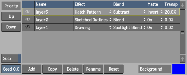

Layer Table Settings
Use the Layer Table to organize the layers that make up your Stylize effect. The top layer in the Layer Table has the highest priority in the overall effect. Selecting a preset populates the Layer Table with the necessary layers and settings.
Visibility column
Displays the visibility of each layer. Click the eye icon to change a layer from visible to invisible or vice-versa.
Name column
Displays the name of the layer. Click the Rename button to change the name of a selected layer.
Effect column
Displays the effect applied per layer. Use the scroll arrows to change the effect. Different settings appear based on the effect chosen.
Blend column
Displays the blend operation per layer. Use the scroll arrows to change the blend value.
Matte column
Displays whether a matte is on, off, or inverted per layer. Use the scroll arrows to change the value.
Transparency column
Displays the transparency level per layer. Scroll to change the value, or click to display the calculator.
Priority Up button
Click to move the selected layer up in priority in the layer list.
Priority Down button
Click to move the selected layer down in priority in the layer list.
Solo button
Enable to hide all other layers except the selected layer. You can also turn specific layers on or off using the eye icon on the left of each layer.
Seed field
Displays the random seed variation value to use in the stylize effect. Editable.
Add button
Click to add a new layer to the layer list.
Copy button
Click to copy the existing layer to a new layer.
Delete button
Click to delete the selected layer from the layer list.
Rename button
Click to open the online keyboard to rename the selected layer in the layer list.
Reset button
Click to reset all of the attributes associated with the selected layer and returns them to default values.
Background colour pot
Displays the background colour used in a blending operation. Click to change the colour.

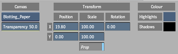

Canvas Effect Settings
These settings are available when a layer is selected in the Layer Table with Canvas as the effect.
Pattern Type box
Select a pattern type to apply to the image.
Transparency field
Displays the percentage of transparency applied to the Canvas effect. Editable.
Position X field
Displays the position of the pattern along the horizontal axis. Editable.
Position Y field
Displays the position of the pattern along the vertical axis. Editable.
Scale X field
Displays the change in size of the pattern along the horizontal axis. Editable.
Scale Y field
Displays the change in size of the pattern along the vertical axis. Editable.
Proportional button
Enable to change the scale fields proportionally.
Rotation field
Displays the angle of rotation of the pattern along the Z-axis, from its centre point. Editable.
Highlights colour pot
Displays the colour applied to the light areas of the Canvas effect. Click to change the colour.
Shadows colour pot
Displays the colour applied to the dark areas of the Canvas effect. Click to change the colour.

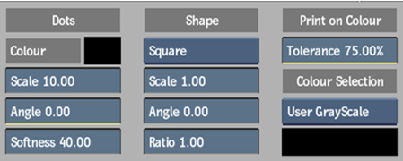

Dots Effect Settings
These settings are available when a layer is selected in the Layer Table with Dots as the effect.
Effect colour pot
Displays the colour applied to the effect. Click to change the colour.
Scale field
Displays the change in size of the effect. Editable.
Angle field
Displays the change in the angle applied to the effect. Editable.
Softness field
Displays the change in softness applied to the effect. Editable.
Shape box
Select the shape of the Dots effect.
Scale field
Displays the size of the Dots shapes. Editable.
Angle field
Displays the change in angle of the Dots shapes. Editable.
Ratio field
Displays the change in ratio of the Dots shapes. Editable.
Tolerance field
Displays the tolerance level applied to the colour selection of the effect. Editable.
Colour Selection option box
Select an option to apply a colour to the image.
Colour Selection colour pot
Displays the colour applied to the image. Click to change the colour. Only active if User Colour or User GrayScale is selected.
Blur field
Displays the amount of blur applied to the input image before other effects are applied. Editable.

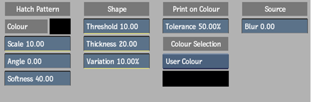

Hatch Pattern Effect Settings
These settings are available when a layer is selected in the Layer Table with Hatch Pattern as the effect.
Effect colour pot
Scale field
Angle field
Displays the angle applied to the embossing. Editable.
Softness field
Displays the amount of softness applied to the Palette Reduction effect. Editable.
Threshold field
Displays the amount of colour constraint applied to the shape. Editable.
Thickness field
Displays the amount of thickness applied to the shape. Editable.
Variation field
Displays the percentage of variance applied to the shape. Editable.
Tolerance field
Blur field

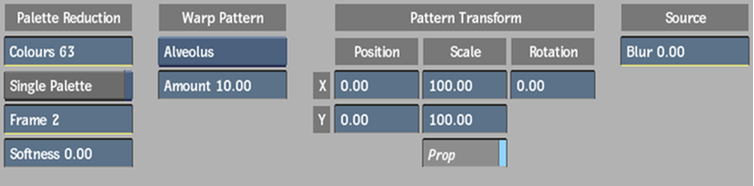

Palette Reduction Effect Settings
These settings are available when a layer is selected in the Layer Table with Palette Reduction as the effect.
Colours field
Displays the number of colours applied to the Palette Reduction effect. Editable.
Palette box
Select between Single Palette to display image stability by using a single colour palette as a reference, and Dynamic Palette to display image transition by using a new colour palette at each frame.
Frame field
Displays the frame selected when Single Palette is enabled in the Palette box. Editable.
Softness field
Displays the amount of softness applied to the embossing. Editable.
Pattern Type box
Amount field
Displays the amount of the selected warp pattern that is applied to the image. Editable.
Position X field
Position Y field
Scale X field
Scale Y field
Proportional button
Rotation field
Blur field

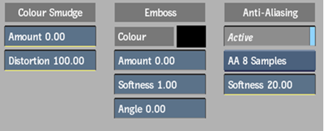

Colour Smudge Effect Settings
These settings are available when a layer is selected in the Layer Table with Colour Smudge as the effect.
Amount field
Displays the amount of Colour Smudge effect that is applied to the image. Editable.
Distortion field
Displays the amount of distortion applied to the Colour Smudge effect. Editable.
Emboss colour pot
Displays the colour applied to the embossing. Click to change the colour.
Amount field
Displays the amount of embossing applied to the image. Editable.
Softness field
Angle field
Anti-Aliasing Active button
Enable to use anti-aliasing on the edges of the image.
Anti-Aliasing Samples box
Select an option to determine the size of the samples. Available when anti-aliasing is enabled.
Anti-Aliasing Softness field
Displays the amount of softness applied to the anti-aliasing. Available when anti-aliasing is enabled. Editable.

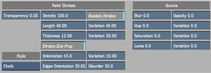

Drawing Effect Settings
These settings are available when a layer is selected in the Layer Table with Drawing as the effect.
Transparency field
Displays the percentage of transparency applied to the paint strokes. Editable.
Style Type box
Select the style type of the paint strokes.
Density field
Displays the amount of density applied to the paint strokes. Editable.
Length field
Displays the length applied to the paint strokes. Editable.
Length Variation field
Displays the amount of variance applied to the length of the paint strokes. Editable.
Thickness field
Displays the amount of thickness applied to the paint strokes. Editable.
Thickness Variation field
Displays the amount of variance applied to the thickness of the paint strokes. Editable.
Paint Each Frame button
Enable to apply a random variation in the length and thickness values.
Preserve Stroke Ratio button
Enable to allow proportional values to be applied to the length and thickness of paint strokes.
Orientation field
Displays the orientation applied to the paint strokes. Editable.
Orientation Variation field
Displays the amount of variance applied to the orientation of the paint strokes. Editable.
Edges Orientation field
Displays the percentage orientation applied to the edges of the paint strokes. Editable.
Disorder field
Displays the amount of random distribution applied to the paint strokes. Editable.
Blur field
Opacity field
Displays the amount of opacity applied to the input image before other effects are applied. Editable.
Hue field
Displays the amount of hue applied to the input image before other effects are applied. Editable.
Hue Variation field
Displays the amount of variance applied to the hue. Editable.
Saturation field
Displays the amount of saturation applied to the input image before other effects are applied. Editable.
Saturation Variation field
Displays the amount of variance applied to the saturation. Editable.
Luminance field
Displays the amount of luminance applied to the input image before other effects are applied. Editable.
Luminance Variation field
Displays the amount of variance applied to the luminance. Editable.

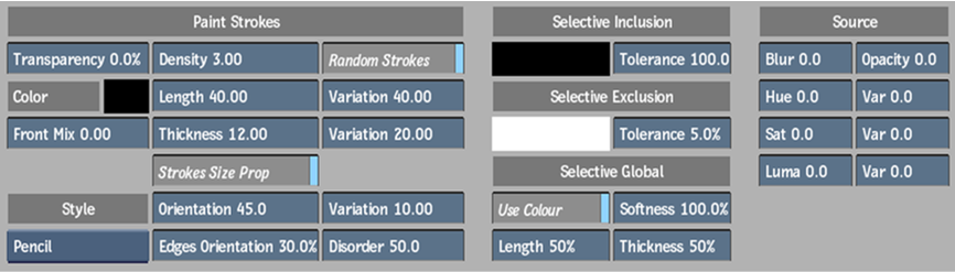

Selective Drawing Effect Settings
These settings are available when a layer is selected in the Layer Table with Selective Drawing as the effect.
Paint Strokes colour pot
Displays the colour applied to the paint strokes. Click to change the colour.
Front Mix field
Displays the amount of colour from the source image that is visible. Editable
Inclusion colour pot
Displays the colour on which the paint strokes are created. Click to change the colour.
Inclusion Tolerance field
Displays the percentage of tolerance applied to the selected colour. The higher the tolerance, the more paint strokes are created. Editable.
Exclusion colour pot
Displays the colour on which the paint strokes are eliminated. Click to change the colour.
Exclusion Tolerance field
Displays the percentage of tolerance applied to the selected colour. The higher the tolerance, the more paint strokes are eliminated. Editable.
Global Colour box
Switch between the use of colour selections or grayscale versions of these colour selections.
Global Length field
Displays the percentage of length by which semi-transparent strokes are modified. Editable.
Global Softness field
Displays the percentage by which the range of transparency of semi-transparent strokes is modified. Editable.
Global Thickness field
Displays the percentage by which the range of thickness of semi-transparent strokes is modified. Editable.

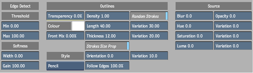

Sketched Outlines Effect Settings
These settings are available when a layer is selected in the Layer Table with Sketched Outlines as the effect.
Minimum Threshold field
Displays the minimum amount of colour restraint applied to the outline edges. Editable.
Maximum Threshold field
Displays the maximum amount of colour restraint applied to the outline edges. Editable.
Softness Width field
Displays the amount of softness applied to the width of the edges. Editable.
Softness Gain field
Displays the amount of softness applied to the gain of the edges. Editable.
Transparency field
Displays the percentage of transparency applied to the outlines. Editable.
Outlines colour pot
Displays the colour applied to the outlines. Click to change the colour.
Front Mix field
Displays the percentage of colour from the source image that is visible. Editable.
Style Type box
Select the style type of the outlines.
Density field
Displays the amount of density applied to the outlines. Editable.
Enable to apply a random variation in length and thickness values.
Length field
Displays the length applied to the outlines. Editable.
Displays the variance applied to the length of the outlines.
Thickness field
Displays the amount of thickness applied to the outlines. Editable.
Displays the variance applied to the thickness of the outlines.
Enable to allow proportional values to be applied to the length and thickness for the outlines.
Orientation field
Displays the orientation applied to the outlines. Editable
Displays the variance applied to the orientation of the outlines.
Follow Edges field
Displays the percentage by which the outlines follow their original position. Editable.

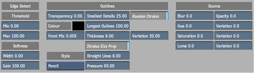

Scribbled Outlines Effect Settings
The Edge Detect, Softness, and Front Controls settings are the same as for the Sketched Outline effect. Some of the Outlines settings are similar also. The following Outlines settings are specific to the Scribbled Outlines effect.
Smallest Details field
Displays the amount by which the smallest outlines will be filtered out. Editable.
Longest Outlines field
Displays the amount by which the length of the longest outlines will be increased. Editable.
Straight Lines field
Displays the amount of the straightest outlines that are visible. Editable.
Pressure field
Displays the variation in the pressure applied to the outlines. Varies with the style of the outline. Editable.

Pattern Type box
Amount field
Displays the amount of warp applied to the image. Editable.
