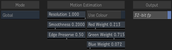

Motion Analysis Menu Settings
Global Mode Settings
Params Settings
Resolution field
Defines the scale of the image to consider in the analysis, 1 being full resolution.
Force 32-bit button
Output a 32bit even if the input resolution is not 32bit
Smoothness field
Controls the spatial coherence of the generated movement.
Edge Preserve field
Constrains the motion analysis to respect the edge information.
Advanced Settings
Red Weight field
Controls the contribution of the Red pixels.
Green Weight field
Controls the contribution of the Green pixels.
Blue Weight field
Controls the contribution of the Blue pixels.
Colour button
Enable to use colour information. When disabled, RGB weights are used to compute the luminance of the input images.
Local Mode Settings
Quality box
Select Use Full Resolution to render the image at the current resolution, or an option with decreased motion analysis accuracy and increased rendering speed.
