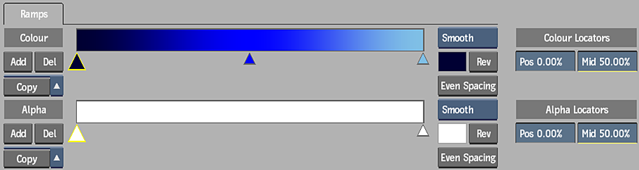

Ramps Settings
Colour Ramp
Displays the gradations of the gradient colours. The triangles below the ramp represent each color in the gradient. You can add more colours to your gradient pattern.
A selected triangle’s colour is displayed in the colour pot to the right of the ramp, and its position is displayed in the Position field. Also, when selecting a triangle, a smaller triangle appears representing the mid point between the colour and the next triangles’ colour. You can move the triangles gesturally to achieve different gradations, and move the mid point triangle to shift the weight between the colours.
Colour Add button
Adds a new colour triangle to the right of the currently selected triangle. Press Ctrl while clicking add to clone the selected triangle colour.
Colour Delete button
Deletes the selected triangle.
Colour Ramp Copy list
Select whether to copy the Colour ramp information to the Alpha ramp, or to preserve the Colour ramp information when switching gradient types.
Alpha Ramp
Displays the gradations of the gradient transparency. The triangles below the ramp represent each alpha colour in the gradient. You can add more alpha colours to your gradient pattern.
Alpha Add button
Alpha Delete button
Alpha Ramp Copy list
Select whether to copy the Alpha ramp information to the Colour ramp, or to preserve the Alpha ramp information when switching gradient types.
Colour Interpolation Type box
Choose a Linear or Smooth gradient interpolation curve.
Colour Colour pot
Displays the colour of the selected triangle. Click to open the colour picker to select a different colour.
Reverse Colour button
Click to reverse the colours of the gradient proportionally.
Colour Even Spacing button
Click to space the ramp triangles evenly.
Alpha Interpolation Type box
Alpha Colour pot
Displays the alpha colour of the selected triangle. Click to open the colour picker to select a different colour.
Reverse Alpha Colour button
Click to reverse the alpha colours of the gradient proportionally.
Alpha Even Spacing button
Colour Locator Position field
Displays the location of the selected colour triangle along the colour ramp. Editable.
Colour Locator Mid field
Displays the weight level between colours on the ramp (represented by the small triangle). Editable.
Alpha Locator Position field
Displays the location of the selected alpha colour triangle along the alpha ramp. Editable.
Alpha Locator Mid field
Displays the weight level between alpha colours on the ramp (represented by the small triangle). Editable.

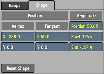

Spline Shape Settings
Use these settings if you wish to further affect the shape of a spline gradient. All of these settings have gestural equivalents in the image window. Ensure that Icons is enabled in the Gradient Setup menu.)
Vertex X Position field
Displays the position along the X axis of the selected vertex. Editable.
Vertex Y Position field
Displays the position along the Y axis of the selected vertex. Editable.
Tangent X Position field
Displays the position along the X axis of the selected tangent. Editable.
Tangent Y Position field
Displays the position along the Y axis of the selected tangent. Editable.
Amplitude Position field
Displays the position of the spline as a percentage of the distance between the first and last vertex. Editable.
Amplitude Start field
Displays the start position of the spline. Use to set the pixel length of the spline. Editable.
Amplitude End field
Displays the end position of the spline. Use to set the pixel length of the spline. Editable.
Reset Shape button
Resets the spline shape.
